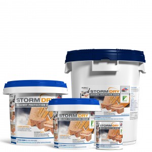

After over 125 years of weathering how porous or permeable are the bricks themselves?
From personal experience I can recommend Stormdry masonry cream. It was easier to apply than I imagined.
As it is invisible when dried it is suitable for spot treatments without giving the wall an odd appearance.
