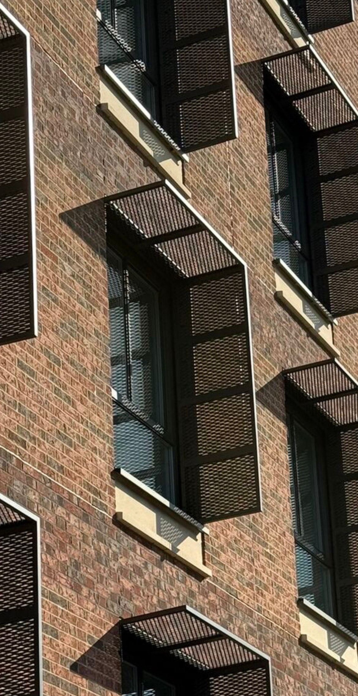

I briefly mentioned brise soleil above. If summer overheating remains a problem this link could be useful.

About the Brise soleil - looking at it I read about orientation and how the the effectiveness of brise soleil can be reduced - our front is approx 130 Southeast facing.
*Horizontal brise soleil ‘shelves’ will not work as well on east or west elevations as the angle of the sun is lower ― sunlight will pass underneath. In these situations, a system that uses multiple vertical blades in front of glazing may be more effective.

A brise soleil across the window would help somewhat too it seems.

Although a brise soleil is usually associated with windows, I know of one family that fitted one along their entire south wall. The brickwork remains cool. The slats of a brise soleil can be vertical if you prefer but should pass left to right rather that to and from a window.
You can build shades for east or west facing walls/windows and they will have some effect but if you have serious overheating then vertical blinds will be best. Something looking like a Venetian blind would be good for windows and vegetation can shade the walls. In winter the blind can be removed but vegetation is generally fixed.
