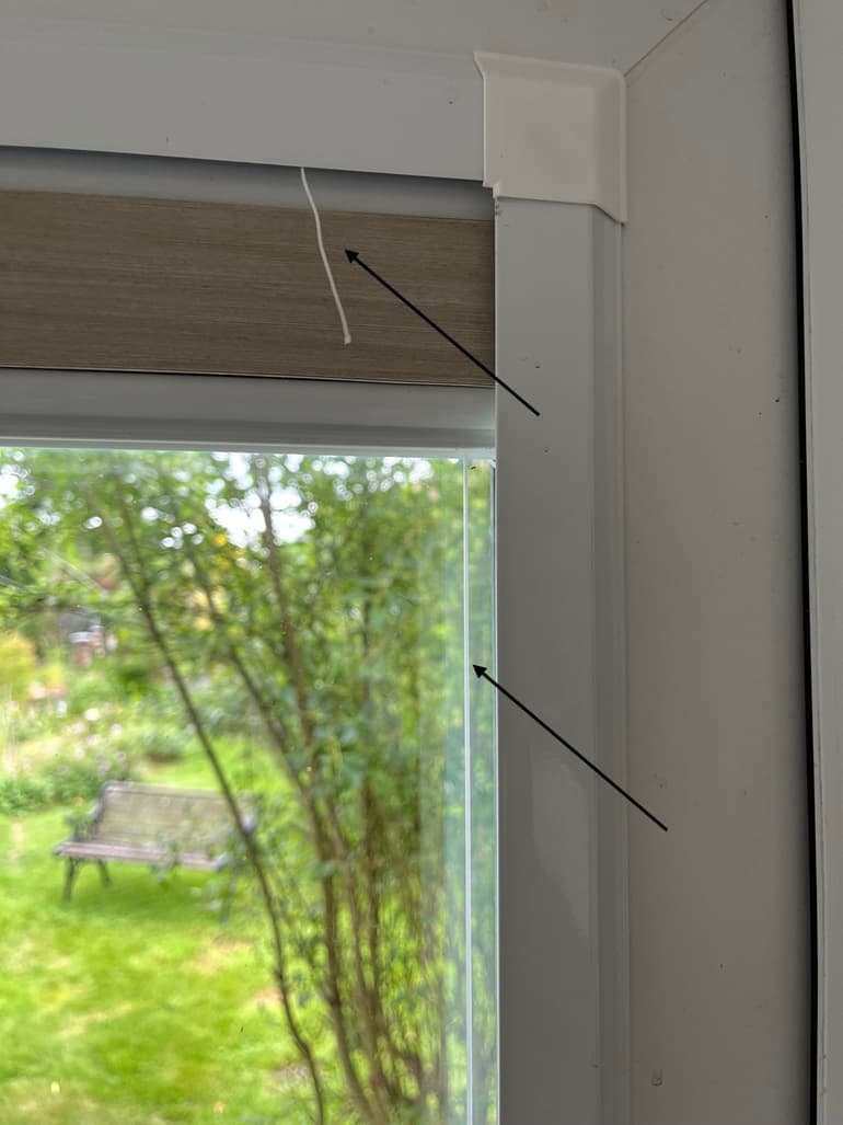

Looking at the photos, I can’t see the cords - do they hang down somewhere or what? We are looking for ones for the roof of a conservatory so having cords hanging down wouldn’t be great. Did you put a toggle to wind the cords round somewhere for each cord? Or how are they operated?

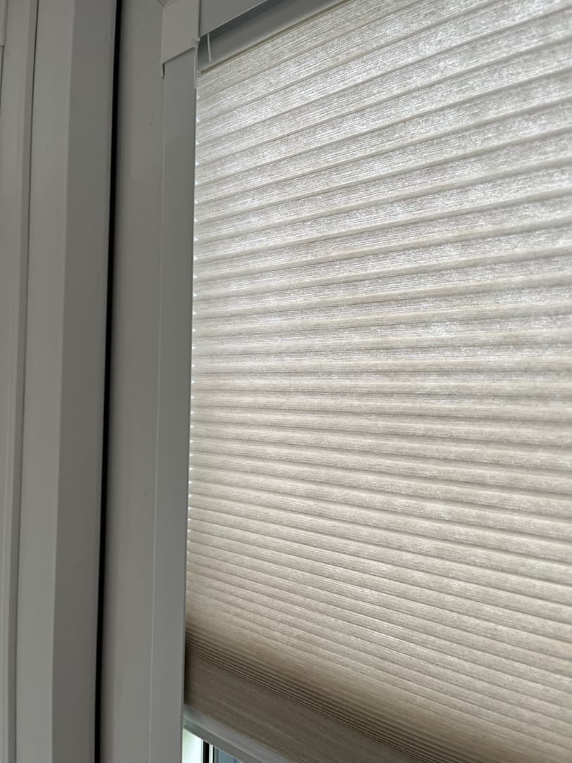

Hi, it is possible for the temperature to rise up to~26-28℃ but we have not been past ~23℃ so far this year. We can reduce glare an use this area whenever we wish for video conferencing. There is a marginal loss of viewing glass but not an issue given the expanse of glass. We have pleated blinds that fold away when not in use to be virtually unobtrusive. You may be able to get a honeycomb version that blocks out more light etc.
The cords hang within the frame and the blinds can be positioned anywhere along the length. The cords can be seen to the edge of the frame but it is not an issue for us. The blinds slide along the cord.

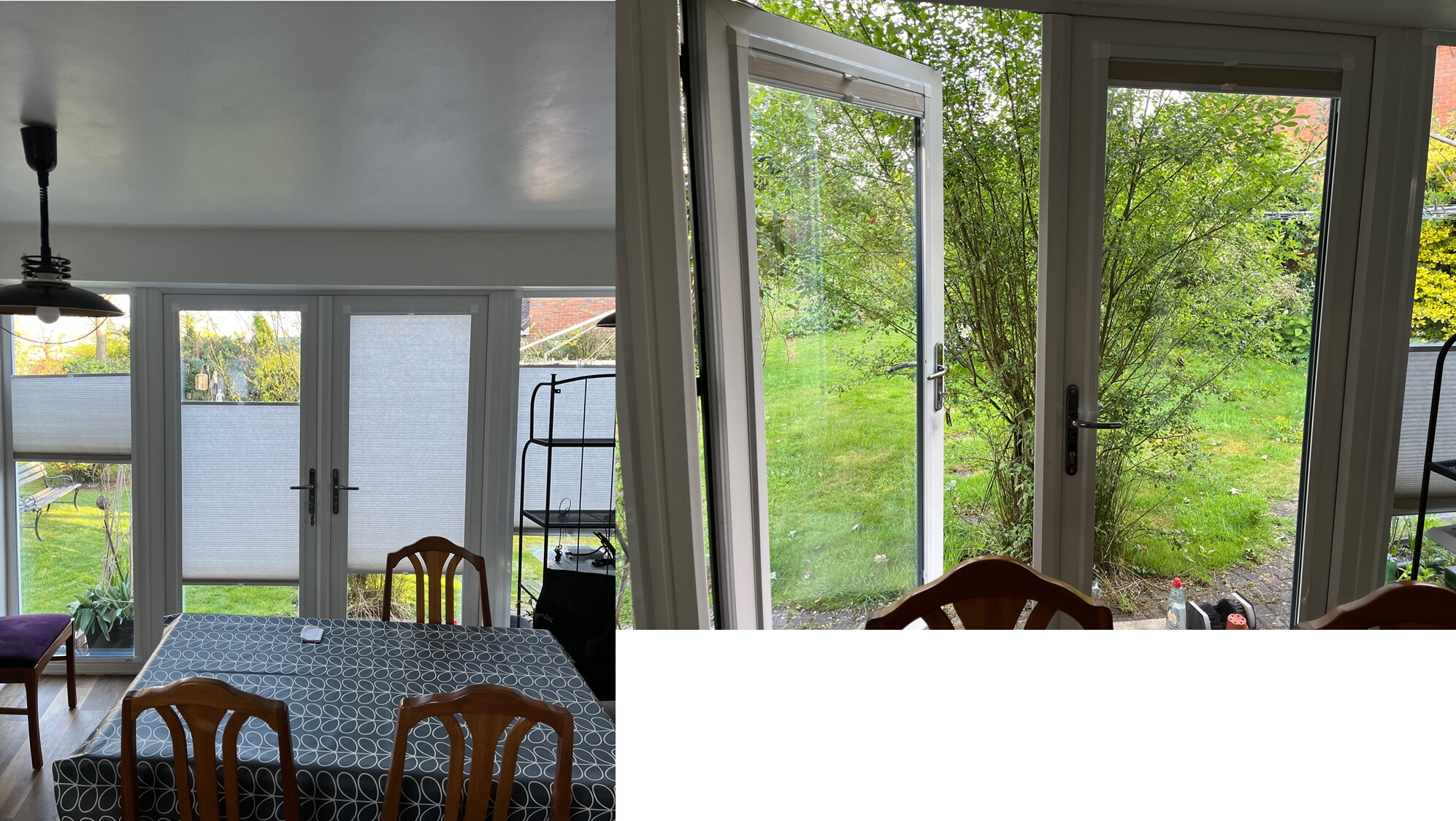

The battery operated system you referenced looks good for a window but I am not sure how wide the largest span would be for a door . I attach further pictures.

The blinds slide along the cords and are adjusted as required as in image below. We have good control over heat gain (South facing) and the blinds extend our workspace flexibility. There are temperature and humidity sensors in this area.
These blinds might not be suitable for your application - (conservatory ceiling) and you may require more flexibility / control .
