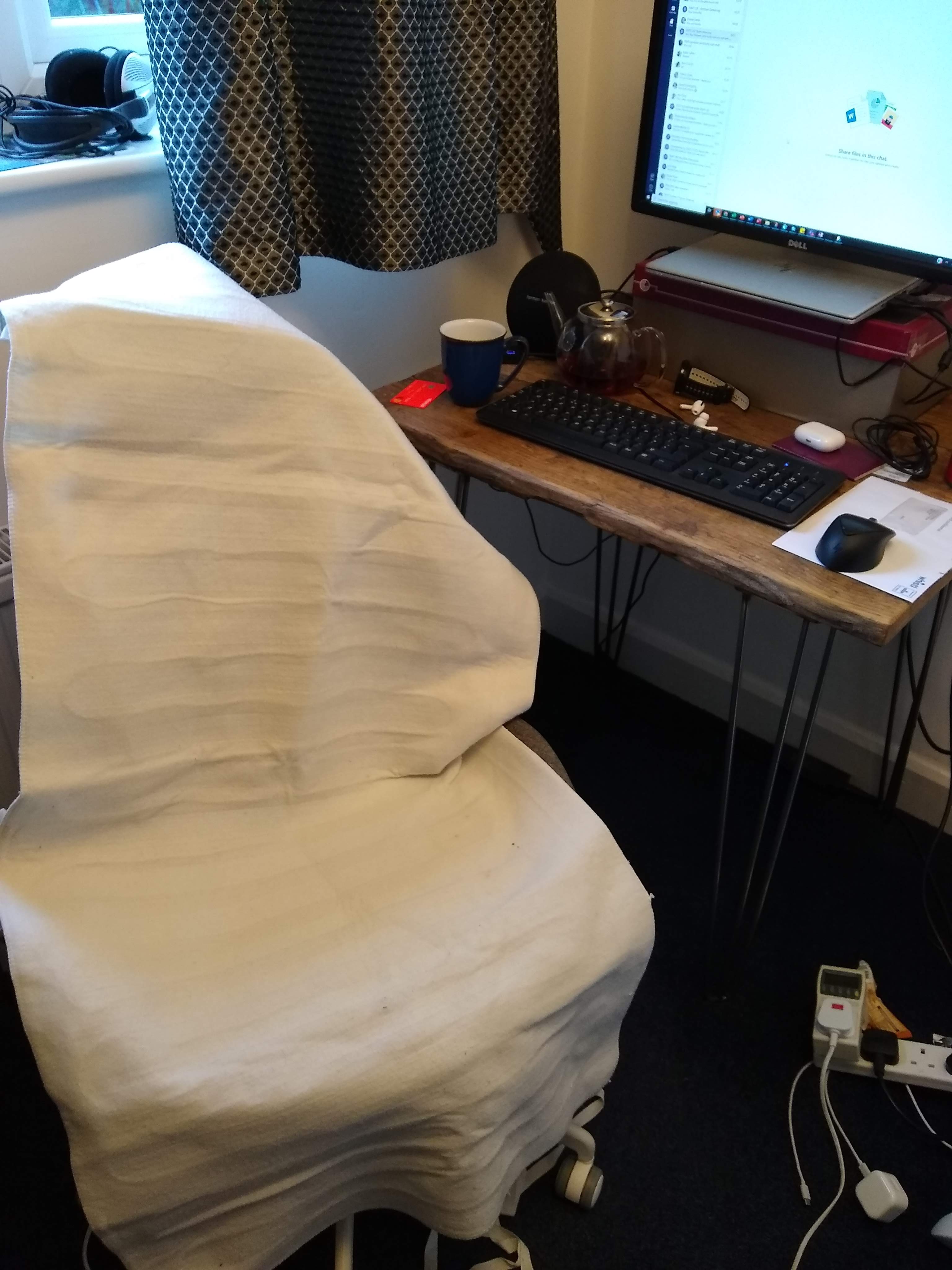

Hi all - hereās a random thread from me on efficient energy use whilst WFH, on the principle of āheat people, not spaceā
Options for me here are:
keep the whole house heated with central heating
heat only the room Iām working in
heat only me
Options for 2. above are convection heating of the whole room - take about 1kW of fan heater
Option for 3. above Iāve found is draping an electric blanket on my chair, wearing hiking socks and a fleece.

Option 3: the electric blanket Iām using now is just 15W!!! And it keeps my rear facade nice and toasty !
Caveat: Iām very aware this doesnāt work if you have good reasons to need to keep the whole house warm e.g. kids, other people etc !
