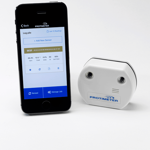

I have found a a few products, OmniSense seems to have a big presence in the US. It is a whole system seems to need a quite expensive base station. There is also this kind of thing. Uses BLE so accessible locally using their APP. Might be an open stream. Not got too into it.
I think might be possible to interpret a WME from a RH value and RH sensors seem to be much cheaper and more available.
