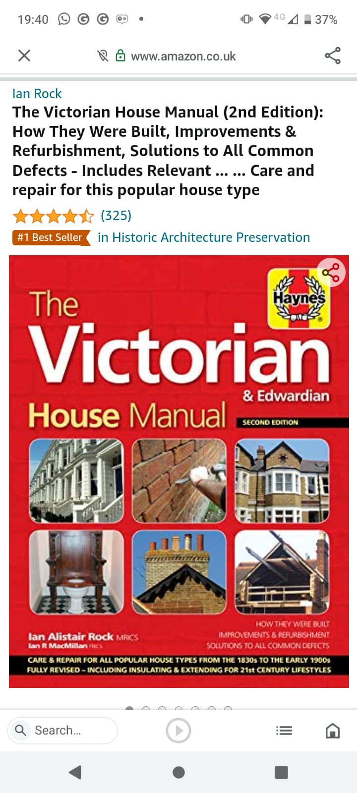

Owing to all of what we’re experiencing with our period home, I just ordered a book about caring for your Victorian home … I think it’s time to understand the bigger picture. Especially as our problems all seem to be about moisture and ventilation.
I’ll keep the topic updated as we progress.
