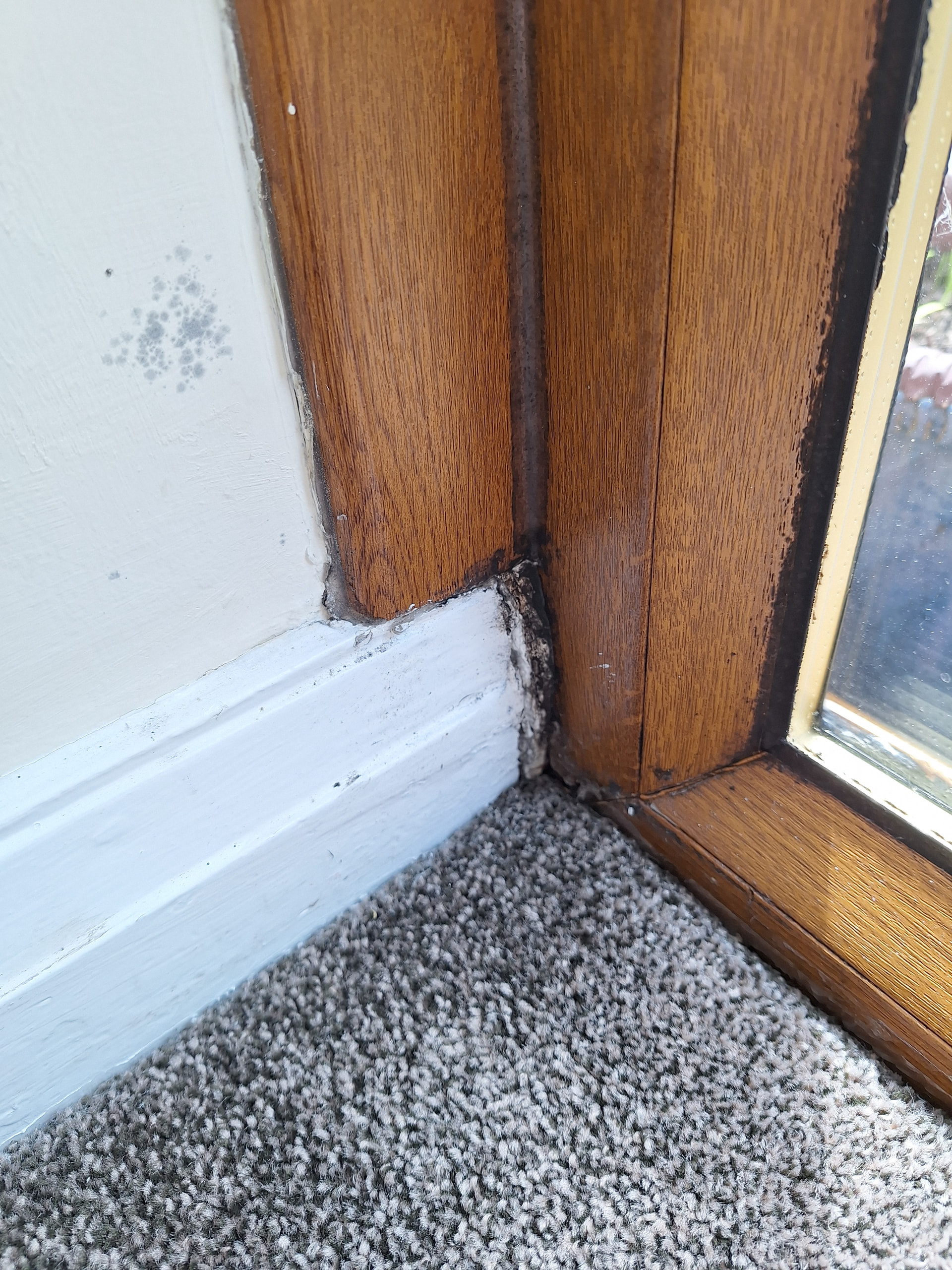

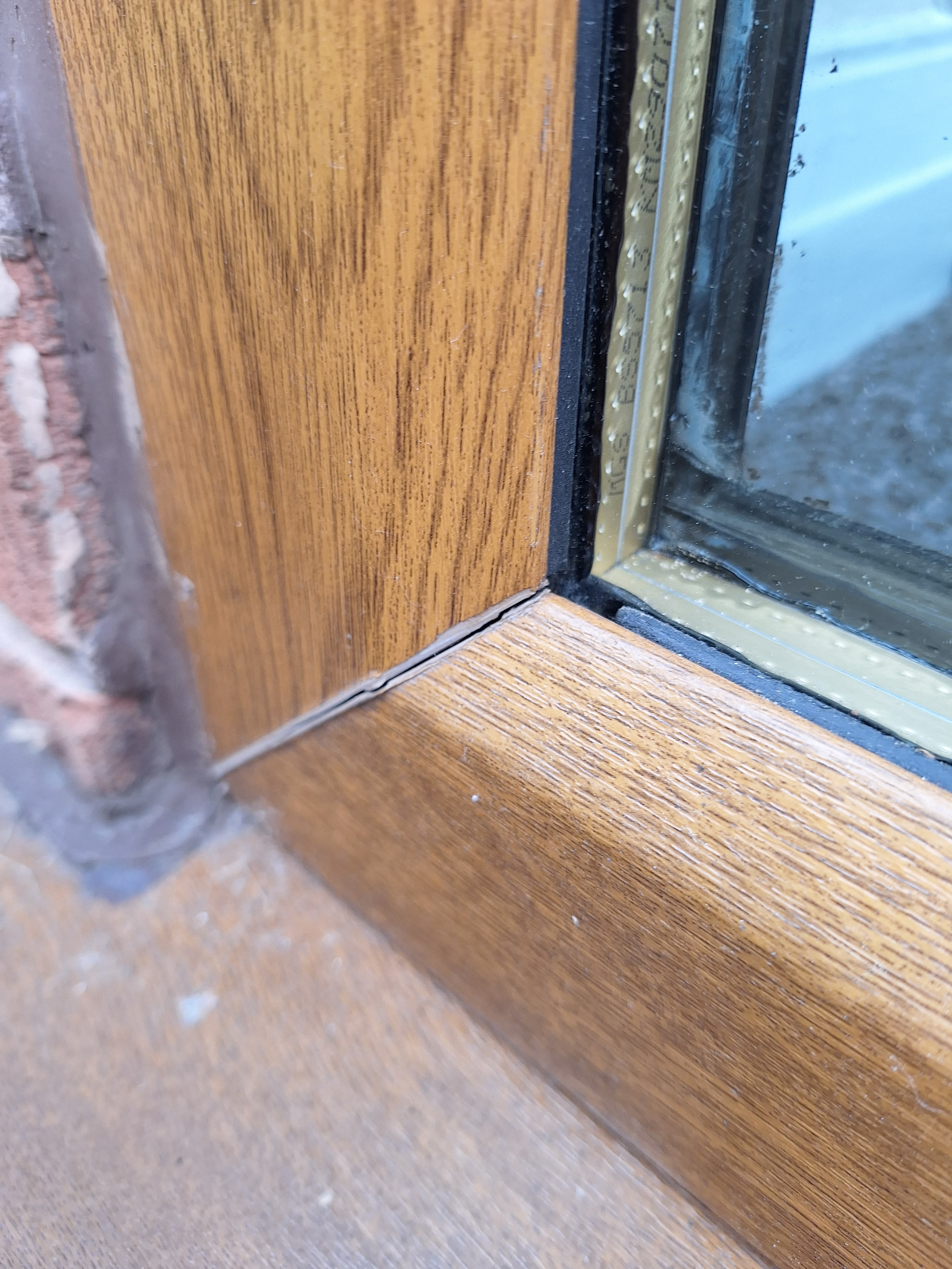

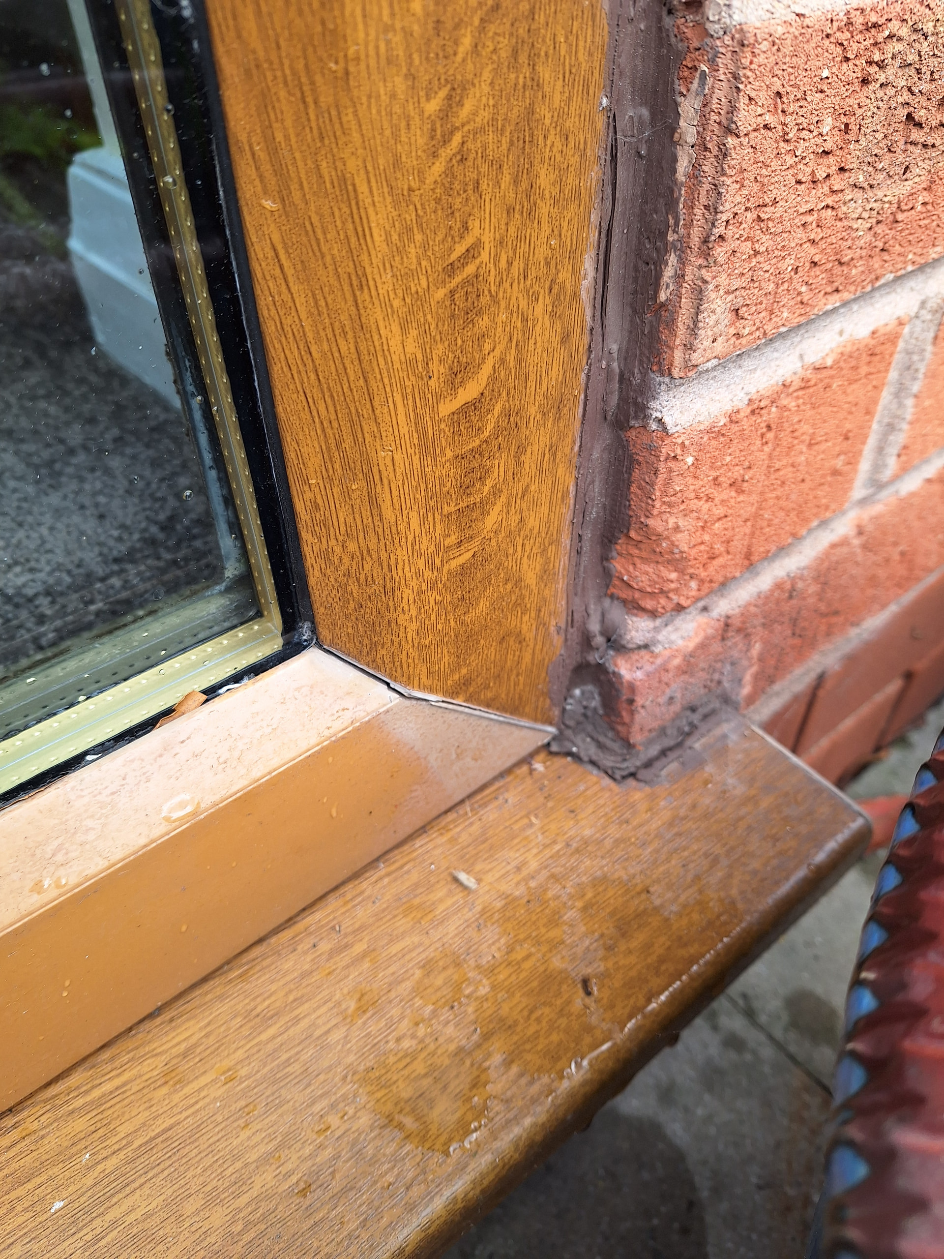

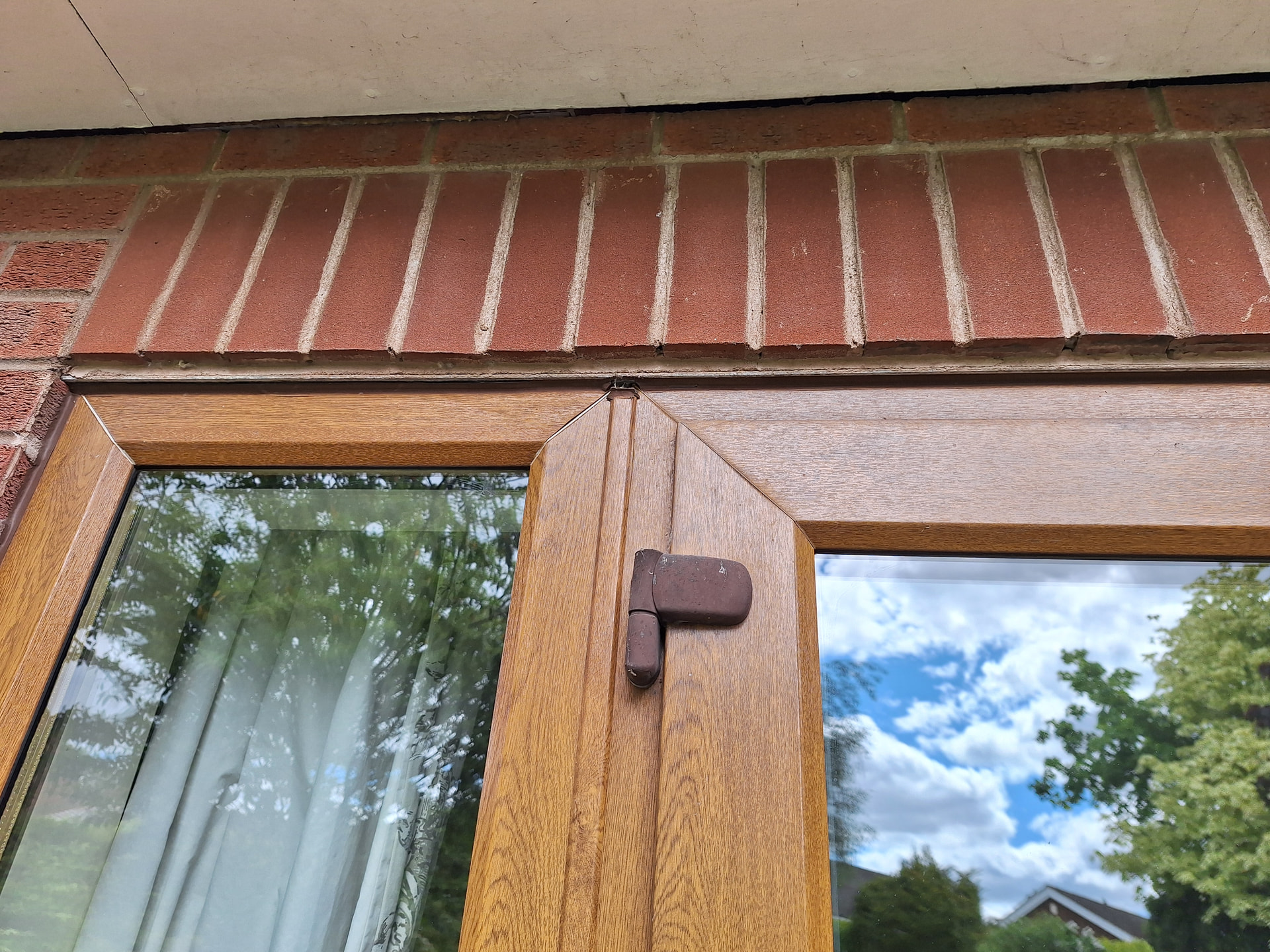

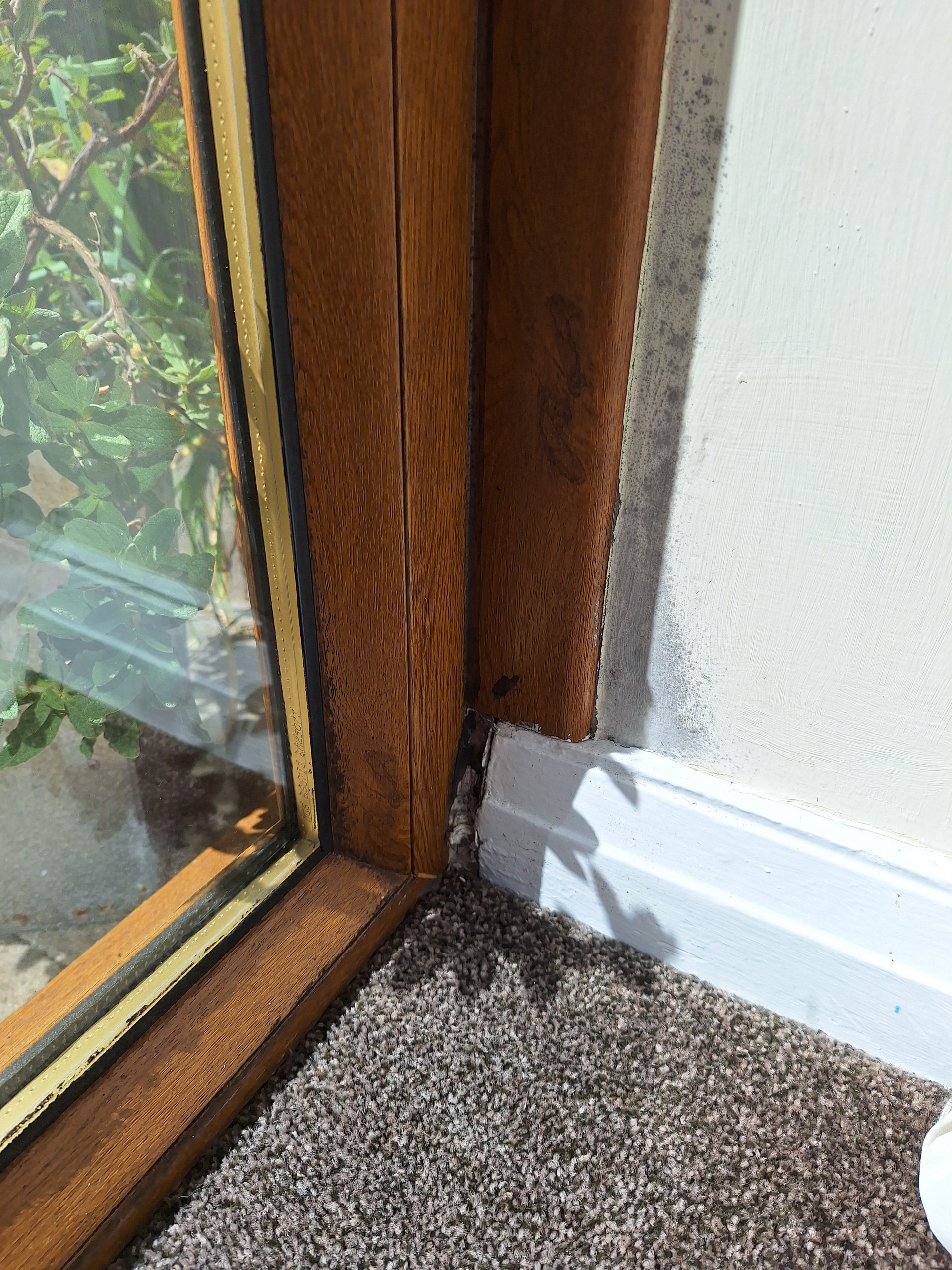

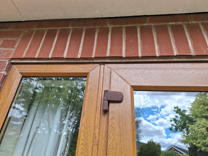

We think this PVC patio door is past it’s best, I think it is 20 years old so we are considering replacing it, it is very leaky and the frame is cracking. All the current windows are PVC and are an oak colour, so I feel like we have to get another PVC window of the same finish, we aren’t planning on replacing other windows yet. But is PVC now considered a bad choice? I guess PVC windows don’t last that long. What other options would be available and what should be done for the installation? I was thinking that the internal plaster needs removing, cap off the cavity and fit insulated plasterboard. There is a steel lintel so I assume this is a thermal bridge so I think that should be insulated internally. Also I have seen tape being mentioned, is this to improve the seal? I have attached some photos of the door below.
The first two photos show damp in the walls each side of the door. Whether that is leakage or cold bridging I can’t tell. At the very least the door and frame need resealing but, yes, it ought to be replaced and fitted properly using airtight seals.
