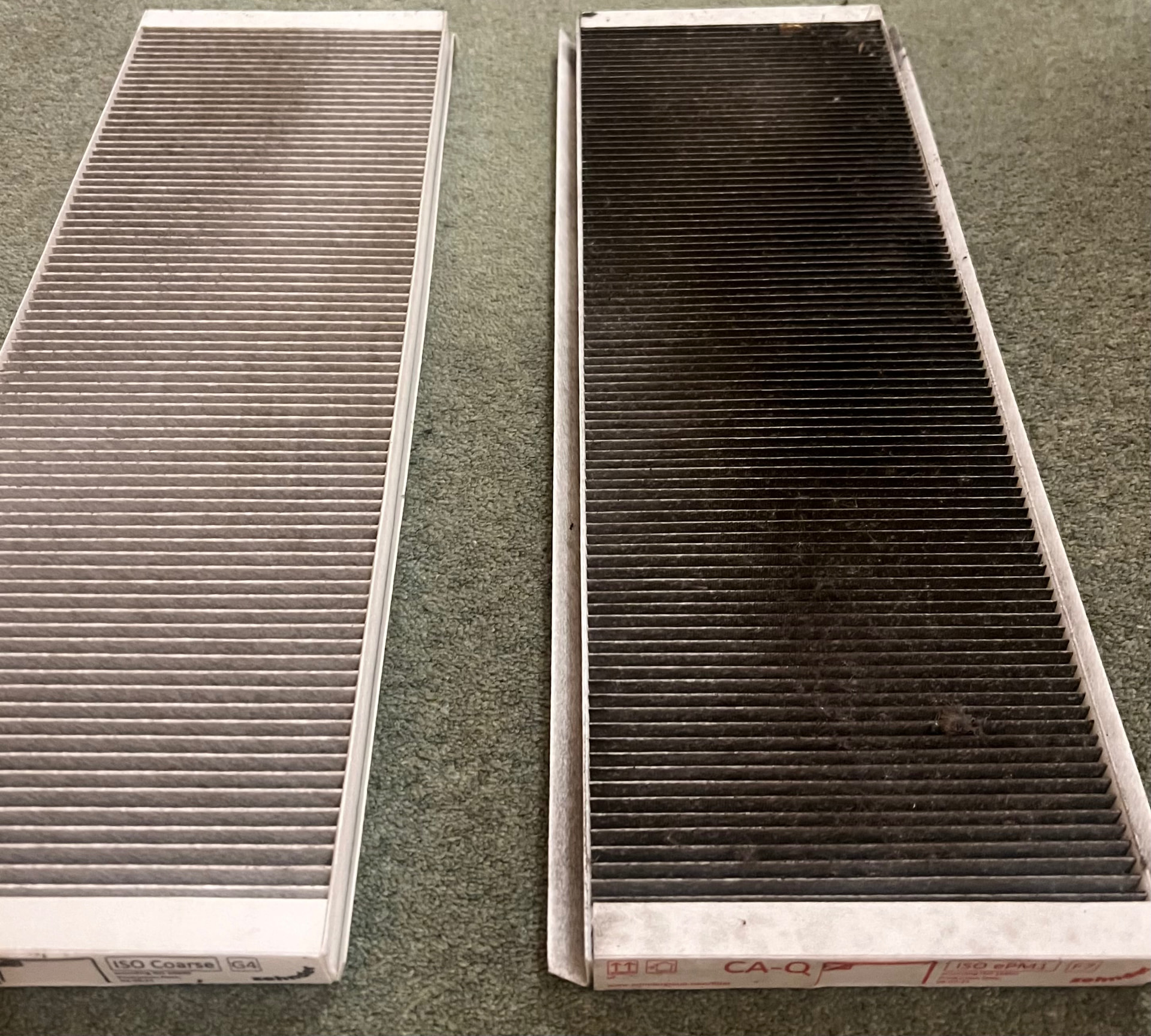

Yesterday my MVHR had its 6 monthly filter change.
Checking the label I see that supply air is filtered to PM1.
The filter on the left is exhaust air and on the right is supply air. No insects but then it was in place for the winter half year.
