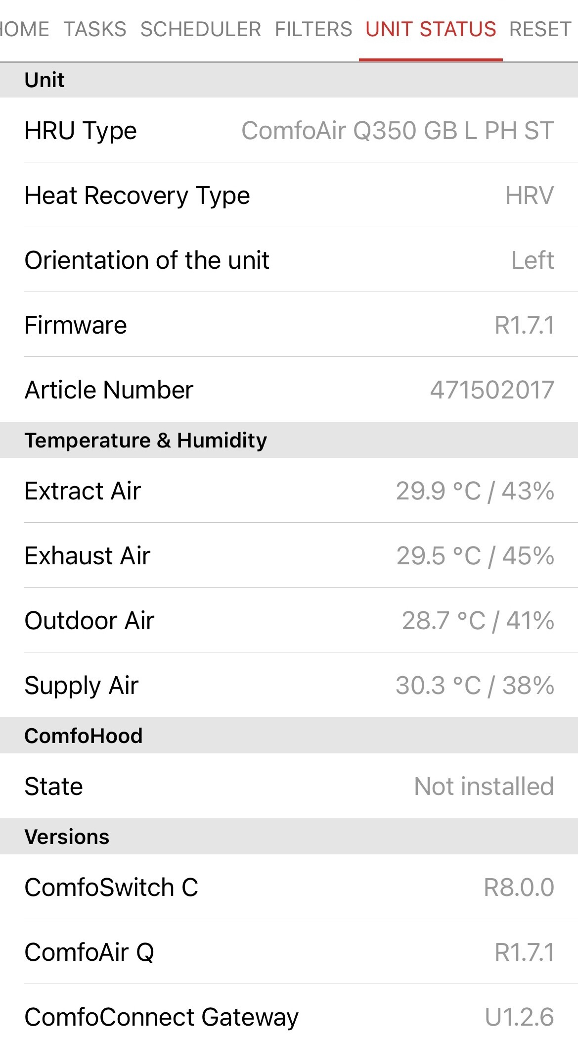

I have a Zehnder ComfoAir and live just north of London.
I kept a close eye on the ventilation during the heatwave and fortunately the app shows incoming and outgoing air temperatures, also supply and extract temperatures. At the high temperatures we were experiencing I could see that the heat exchanger was being bypassed, but the incoming air was still getting slightly warmed as it passed through the unit and extract air was still getting cooled. I suppose it was unavailable when the airflows were so close.
Example below
Typically the air supplied would be 1-2°C warmer than the outside air. I would minimise airflow when the house was warming up (inflow warmer than outflow) and purge ventilate at night when the air was cooling (inflow cooler than outflow).
The house was clearly getting a lot of energy input other than the warm air, as during the day the extracted air could be 5 °C warmer than the inflow.

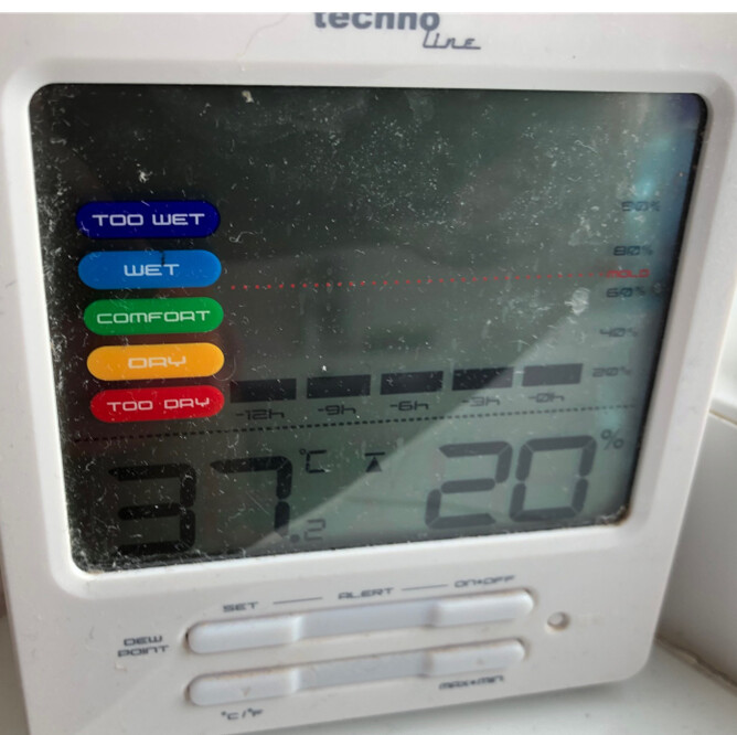

We have a reasonably well insulated home and normally use blinds and cross ventilation to control solar gain. On the hottest day in question, blinds were down and the windows closed. By 1.30pm the internal temperature was 24.5℃. The trees and shrubs were swaying, and I (mea culpa) opened the windows. By 2.30 pm internal monitor showed temperature 37.2℃ and low humidity below.
