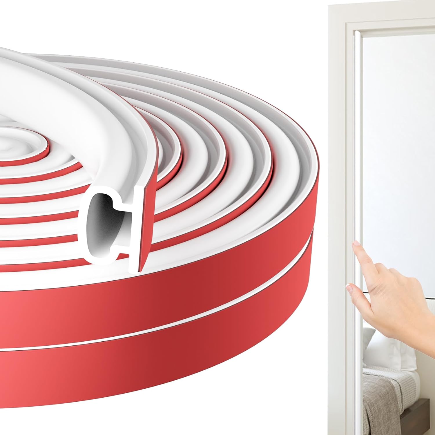

Replace or repair the front PVC door, but it looks in good condition and doesn’t seal when shut.

Maybe all you need is something like this:
