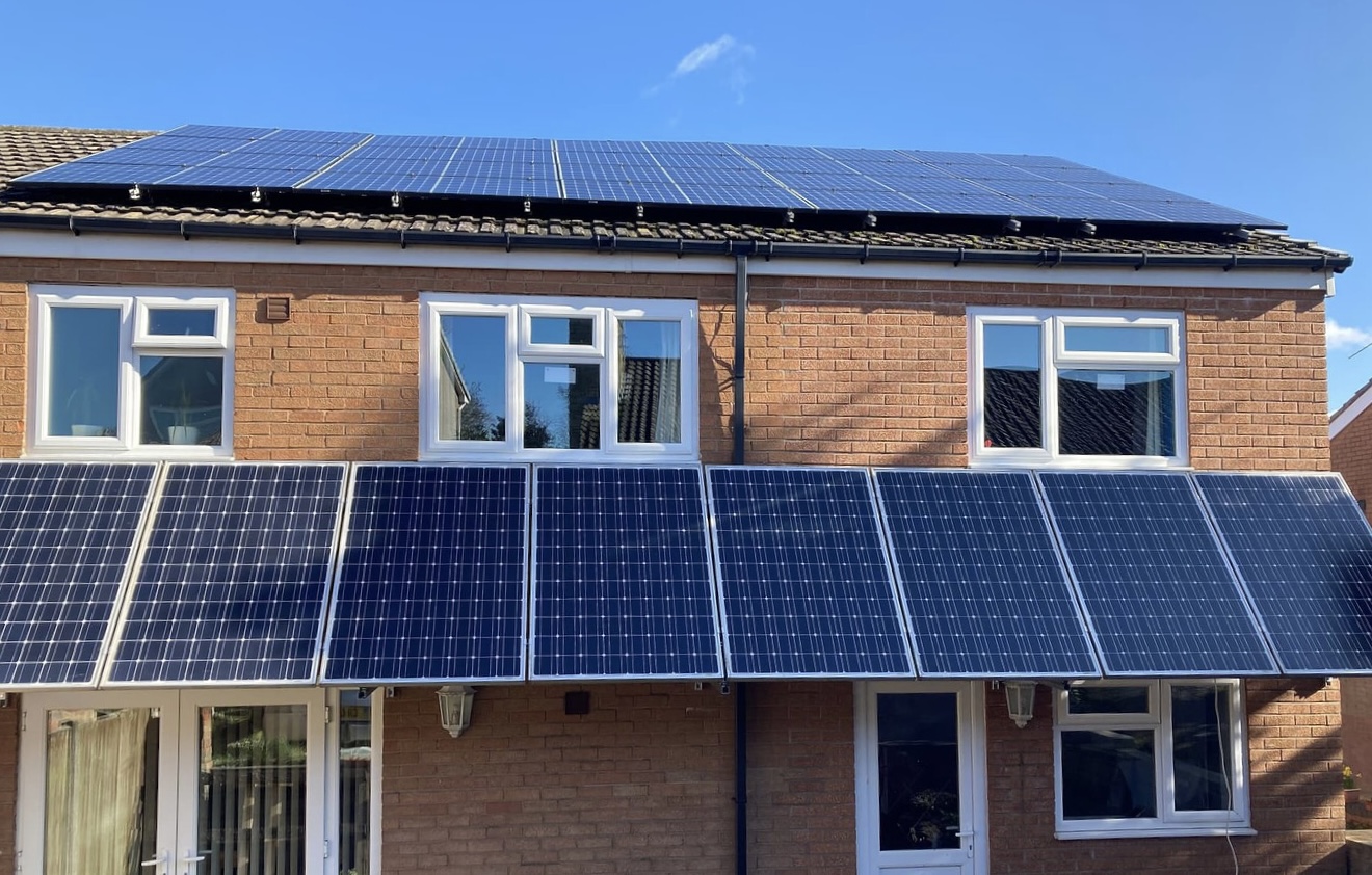

I am planning to fit brise soleil made of solar panels. That is unfortunately the extent of the plan so far, so no details to share.
Something along the lines of this one posted on the Octopus forum:
Thanks for the suggestions, Tim.

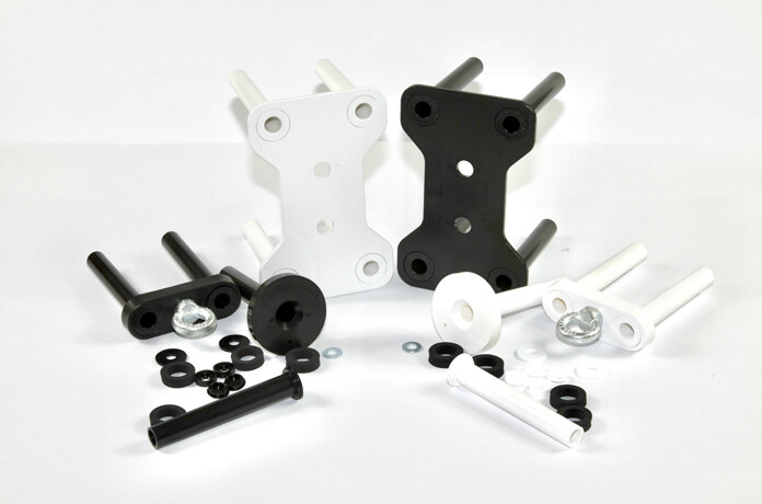

Hi @Chris_Wilkinson. I’ve used these for retrofit…
https://www.phstore.co.uk/insulation-fixings/fischer-thermax-stand-off-fixings
Not 100% thermally broken, but better than the average bolt if that is the alternative in a given situation
