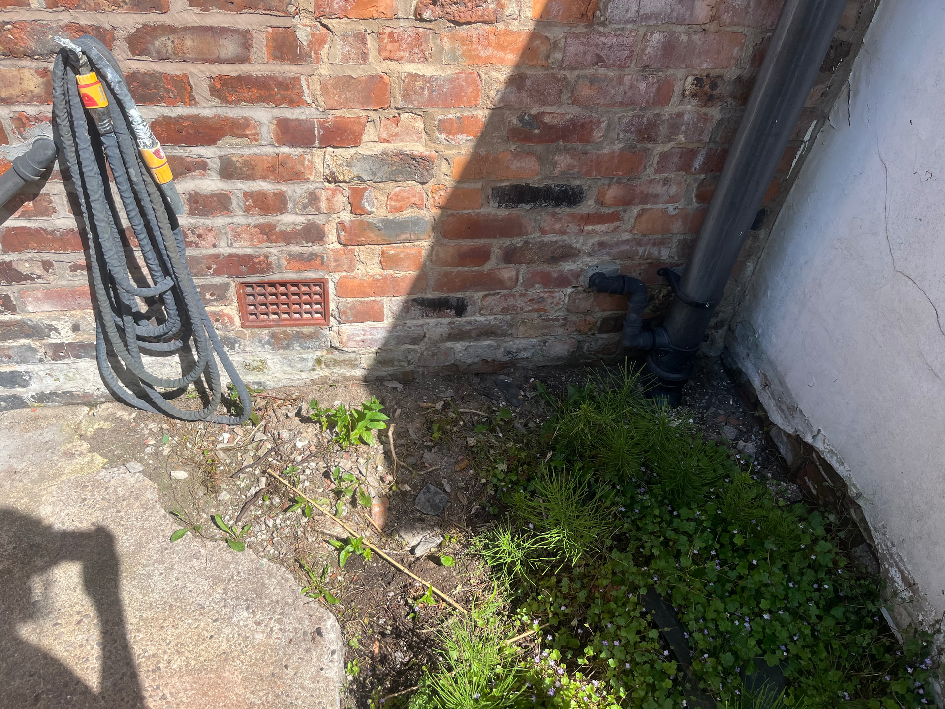

On the outside I’ve taken up rotten decking witht a view to building some raised beds, to find a mix of concrete and soil by the house walls. I’m wondering what best to do to help avoid drainage issues by the house wall especially since the space under the suspended floor is less ventilated now (we do have air bricks, but had bare floorboards before that were really draughty)
The lowest level of bricks look a bit damp, have algae growing on some of them both on the soil and concrete bits, but think they are all below floor level.
Do people think I should do something to drain water away from the house? What would be doable safely around the soil pipe? I’ve got some spare pavers from other bits of the garden, i was thinking of paving the parts close to the house walls with a fall to encourage the water away from the house

Thanks for this advice! I did think about something to drain surface water down away from the level of the crawl space, like digging a narrow trench by the wall and filling with chippings. Do you think that would be better than paving to drain water away from the walls / doing nothing?
The problem is its really hard to dig in our ‘garden’, its why I wanted to build raised beds for planting. The concreted bits are obviously a no-go. The exposed ground around the soil pipe is maybe 80% old bricks, I think it must’ve been paved in bricks once and has since been filled in. So digging a trench through it for a drain away from the walls is really hard. Even digging a trench against the wall around the soil pipe feels dicey, really dont want something to shift and end up with sewage leaking! maybe thats me being unduly nervous.
This is all in the context of the clay being really hard to dig out, and not really wanting to disturb the ecosystems that have already vaguely made their way through the mess thats under there.
I might try digging out a trench by the wall today and see how it goes, then go from there
