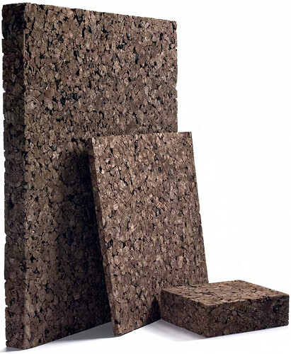

I’m looking at EWI options for a drafty old solid walled house at the moment. Looked at corksol (decent lambda value: 0.45 or so) but it was too expensive. But I’ve happened across cladding, which seems much cheaper on the materials side. Stuff like this:
Other suppliers exist, naturally, but I’ve not decided on who seems best yet.
What I’d like to know is, has anyone here gone down this path? Are there snags and gotchas awaiting me? I’m trying to get 20-30mm of good, breathable insulation on before mid autumn for reasons I’m sure everyone can guess.

This looks like an interesting product. I’m keen to follow your progress. The thermal transmittance is very close to Rockwool EWI batts.
Provided the house is only 2 storeys I would be happy with it. Cork will burn at high temperatures so I wouldn’t add it to anything taller.
I anticipate higher fitting costs than CorkSol or Diathonite as there is more preparation and finishing off than with a spray on solution, so you may not save as much as you expect.
Whichever solution you go for remember not to stop at the soffit but to insulate up to and abutting/overlapping the roof insulation, otherwise you will end up with a cold band around the top of your top floor rooms, which will attract condensation and mould.
