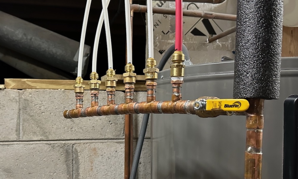

To be honest, ive never actualyl come across a manifold system in real life.

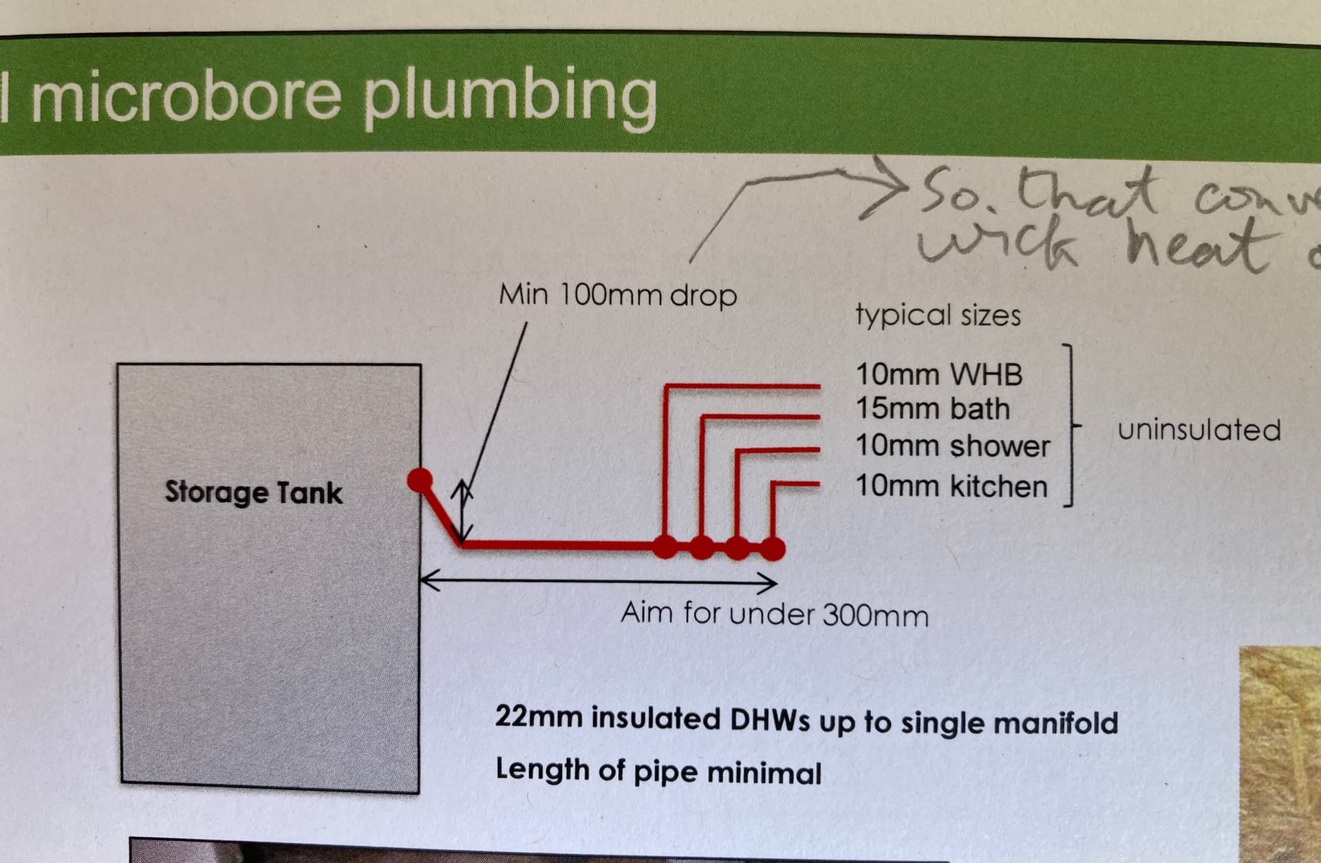

For a passive house, new build or retrofit, radial small bore hot water pipework is normal. In the third photo in the linked articel (the one captioned “Larry Weingarten likes to put the hot water manifold…”), the manifold with valves straight on top of the tank looks like a pretty good radiator. The Passive House recommendation to avoid this, is to have a minimum 100mm drop from the tank outlet to the manifold, and to insulate the manifold. See attached diagram: no need to insulate the radial pipes.
