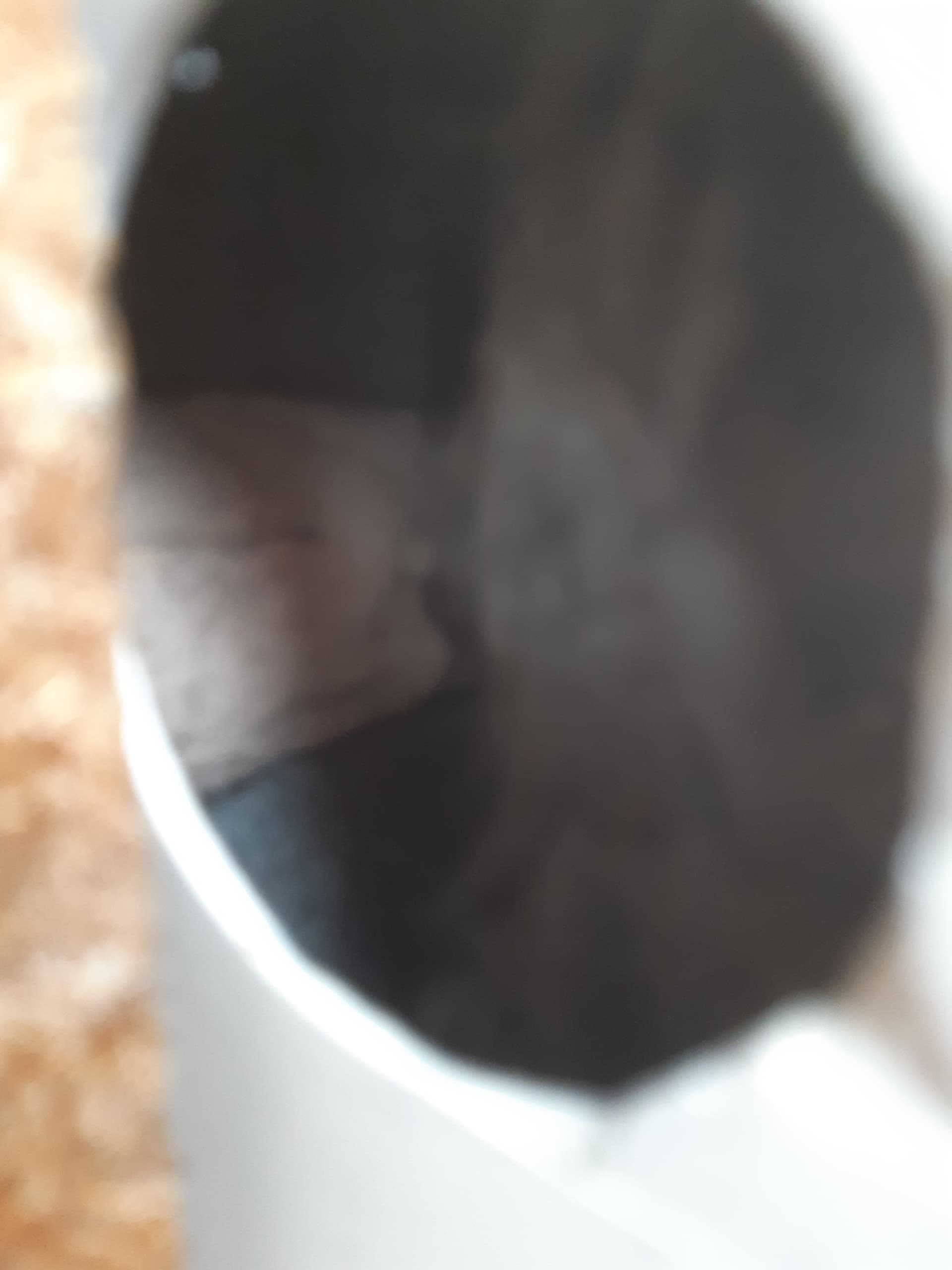

I think the insulation is in batts, i don’t think it has been retrofitted. This is the best image i can get with my phone. It seems to be in contact with the outer wall, there is a small gap to the inner wall.
Ok. That on its own explains the cold feeling against the inner wall. The insulation should be tight against the inner leaf with no air gaps. The last place it should be is against the outer leaf. I don’t know how prevalent that knowledge was when your house was built.
