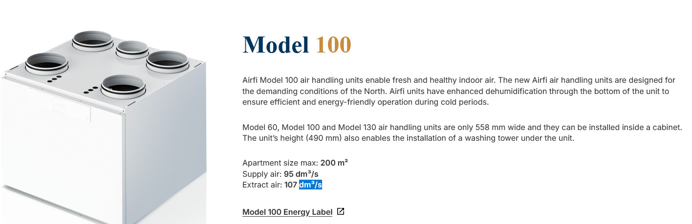

I am planning to install MVHR in my bungalow - 80 sq m on the ground floor and another 40 in what will be the converted loft. I had a quote from 21degrees had previously mentioned Comfoair Q 350 which they said looks like it would be a tight fit but they are also doing a smaller unit called an AIRFI model 100.

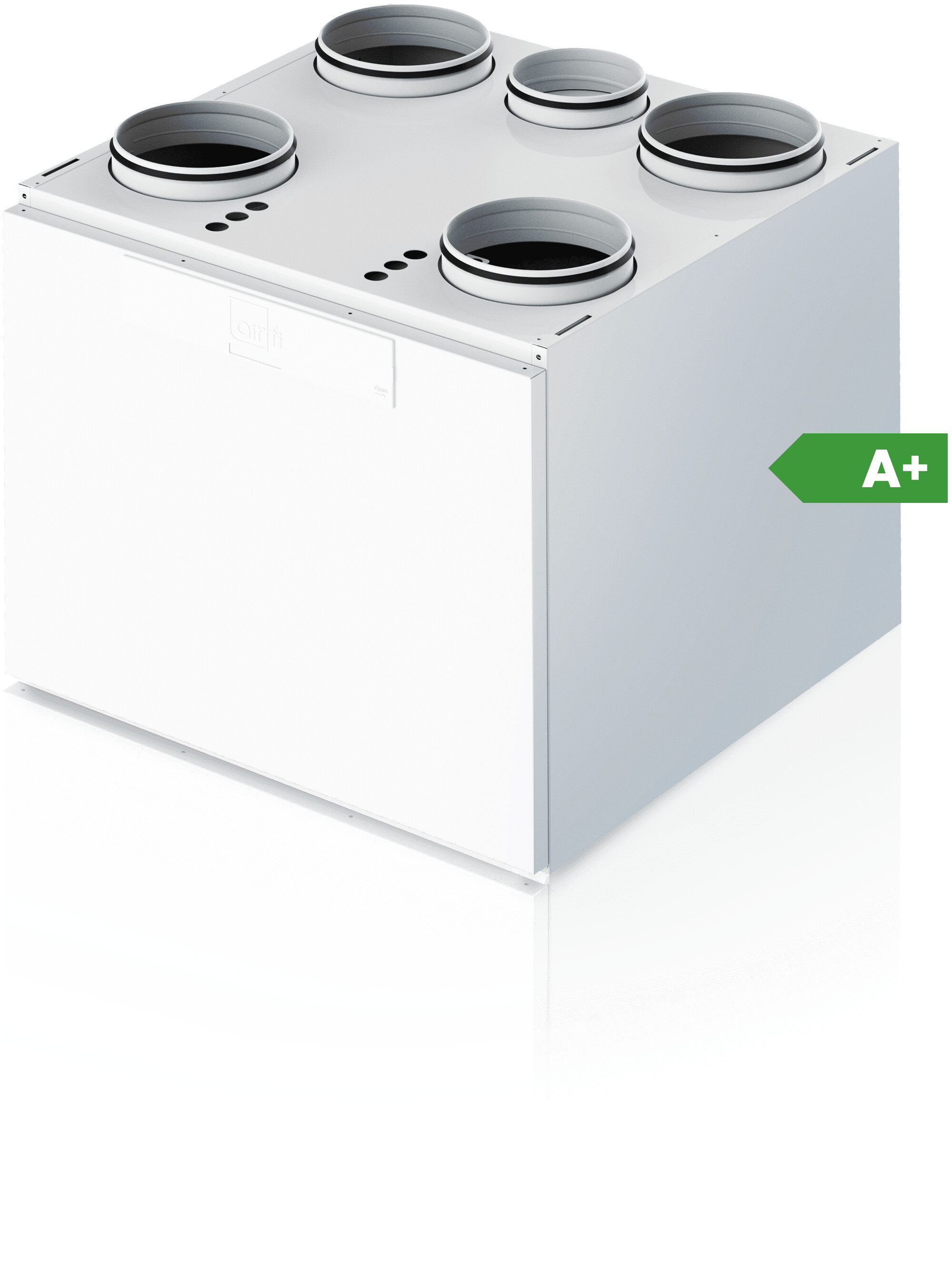

The Airfi units are Finnish and have a kitchen bypass, which I found really useful on my previous Norwegian system, however it is not Passivhaus certified. I can’t see a % efficiency but is is EU energy rating A+/A
If you have 1 kitchen and 2 bathrooms then you have a design airflow rate (max)140m3/h max ventilation.
So instinct tell me that a unit that supply 100m3/h which i presume the airfi 100 does. would not be enough?
Obviously you will generally be ventilating at a lower basic ventilation rate that is maybe only half the max. But i would be a little hesitant. Maybe a question you can ask 21 degree? i would be interested to hear their response.

The 100 refers to 100dm3/s!!!
which is quite the units!!! this translates to 360m3/h … so you will be more than fine!
But it does beg the question if you only require 140m3/h then there will be slimline products out there, that would be much smaller, so easier to install in your space, and of course significantly cheaper! I guess it depends what products 21 degrees sell.

21 degress replied by saying;
the AIRFI unit that we would use is called the AIRFI model 100 but its capable of more than 100m3h (more around the 220m3h benchmark for speed 3, which will comfortably cover your property, the 100 refers the model number, unlike the zehnder units which have the maximum flow in their name, which the person on the thread is likely referring to).
Not just Zehnder but other manufacturers include airflow in their product names. It is understandable that using a number not related to airflow causes confusion.
My old Villavent 400R moved 400m3h, so the habit dates back to the start of the century, if not before.
Yeah i think it does refer to airflow, jsut with a different unit as i suggested earlier:
But good to get some confirmation
I’m inclined to agree with you Russell. Unless 21° checked with the manufacturer their answer is just as much supposition as anyone else’s. When I lived in Scandinavia there was a lot of use of deci- prefix. Fair enough, it is a deci-mal system. I had to get used to decimeters and decilitres in everyday usage.
Probably too late but we fit the AIrFi units for 21 Degees. 21 Degrees also sell them. Back in March 2025 21 Degrees would have had them but were not actively ‘pushing’ them because they had not been signed off by BRE. They now have been signed off. We rate them - powerful fans and seemingly quiet. We fit MVHR systems for a job so we don’t end up living in the house we fit! I would rate them on a par with the Zehnder units. On the whole we do not recommend putting the units in the attic - you have to change the filters every 6 months. Put the boiler in the attic you only have to service that once a year.
