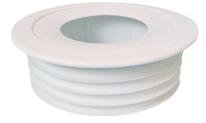

I thought of this:
But it still needs the flue to be removed and reinserted, admittedly without re-drilling the wall.
