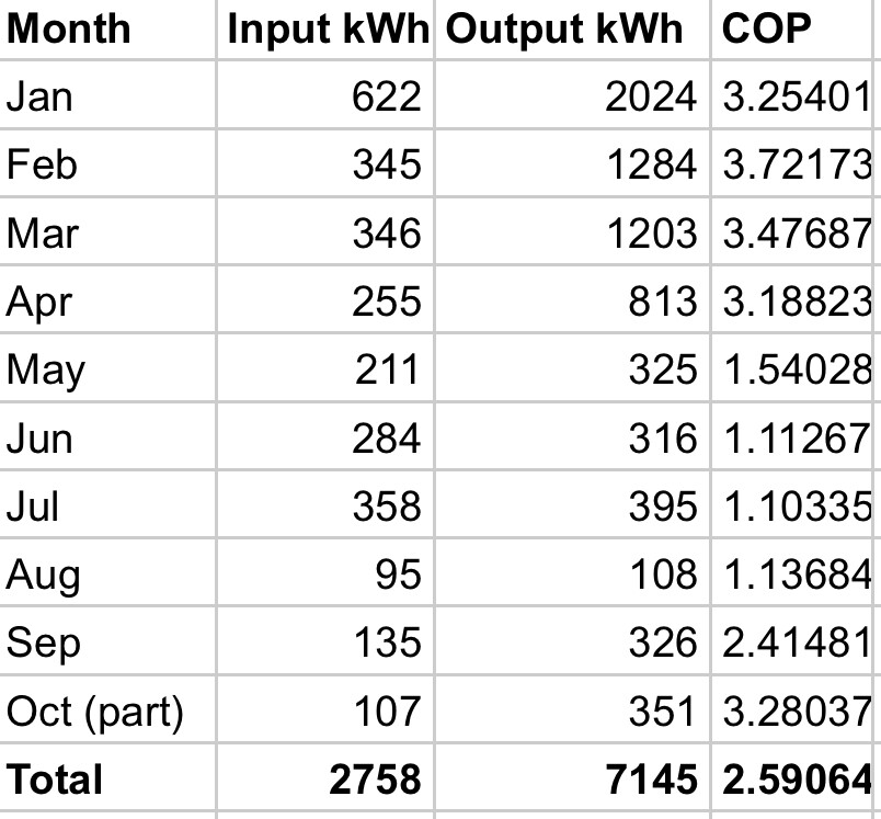

I’ve just been looking at heat pump efficiency for the year so far. There is no point looking further back as all the settings have been changed.
Daikin show energy input and heat output but not in a very friendly manner and only on the indoor controller. Input is available in the app for limited date ranges.
I am very disappointed in the monthly COPs. Only in February did I exceed 3.5. July was worst at 1.1, which allowing for losses in moving heat from the HP to the cylinder was probably less than an immersion heater and it added to overheating indoors.
I should point out that the primary source of hot water in summer is my solar thermal system, so overall consumption is down and I was only topping up when we had cloudy days.
Rather than 2 sets of figures for heating and hot water I used the sums provided by Daikin and typed them into Google Sheets, giving this:
I am partly blaming the low COPs on the buffer tank fitted in my system when in fact I have a significant volume of water without it. Without the buffer all generated heat would pass through the radiators, the flow temperature would fall more and the heat pump would be heating cooler water, which has a higher COP.

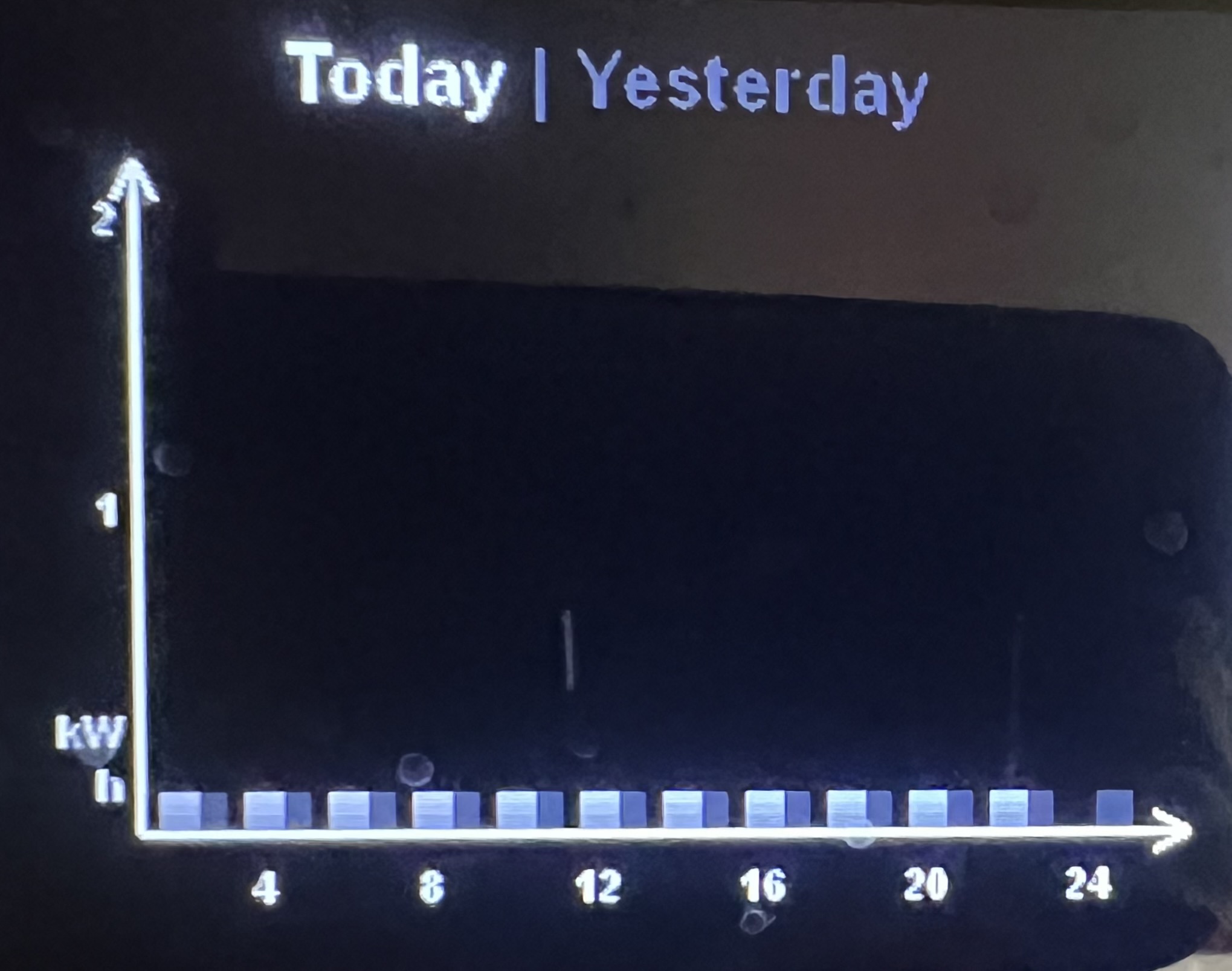

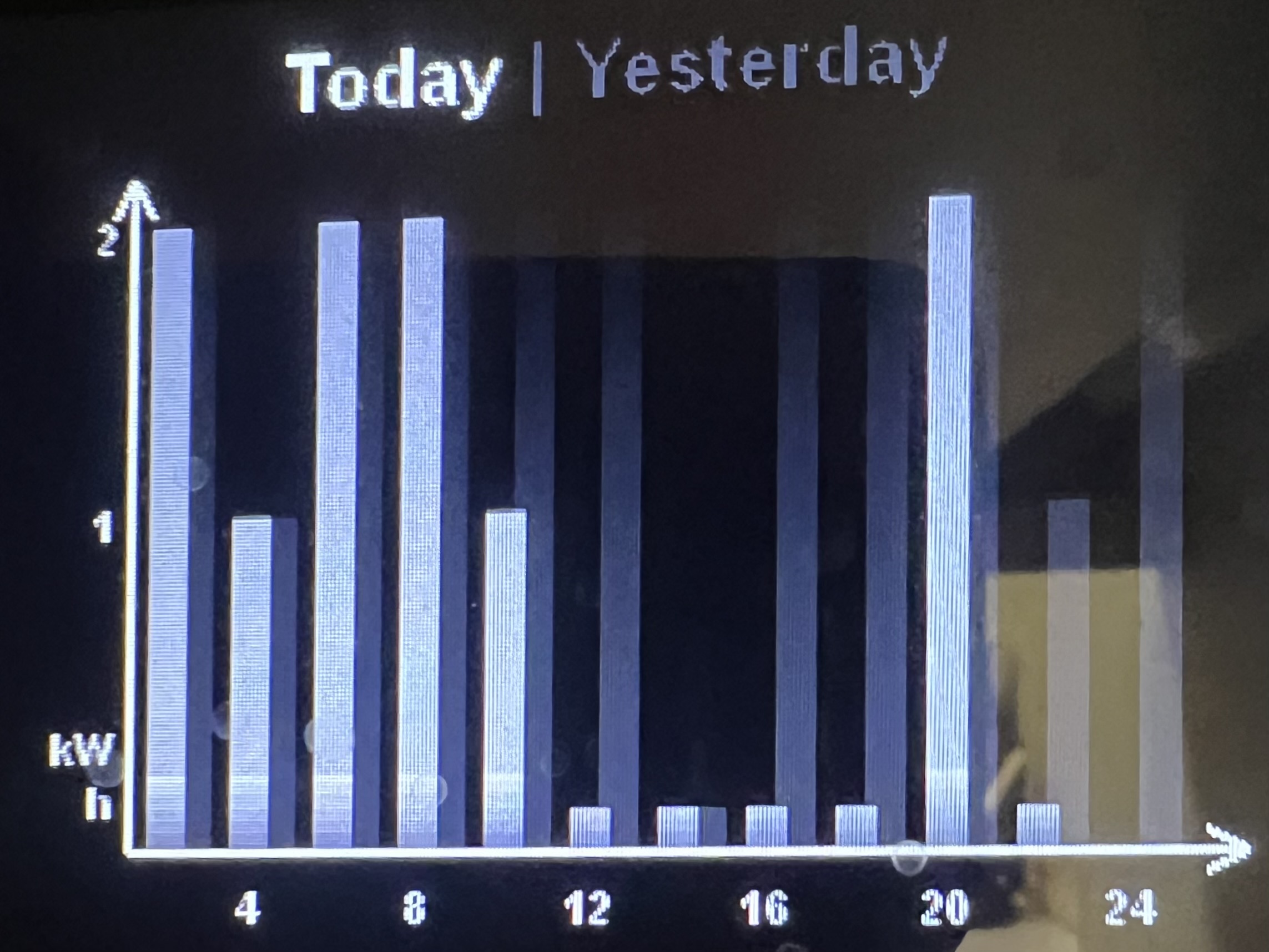

Last weekend I explored the installer settings on the heat pump in more detail than previously. I discovered an option for “normal”, “low energy” and “extra low energy”. I thought it was worth a try and changed the setting from “normal” to “low energy”. If I found no down side I would then try “extra low energy”.
I am currently at the mid point and so far all seems fine. I checked the graphs for input and output and feel that the COP is better than before, but don’t have figures that I could put into a calculation.
Input:
Output:
It looks as though operating the heat pump uses the same amount of power as on standby.
