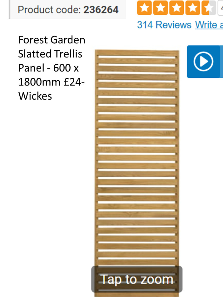

I have recently spotted this item as a candidate for movable external window shading on simple hinges
Mounted with a ventilation gap behind this looks good.
How would you mount them to avoid introducing thermal bridging into the wall structure? That is a general question, not specific to this type of shading.
I’m contemplating sails over some of our windows but they need fairly heavy bolts to not only support them but also resist wind forces.
