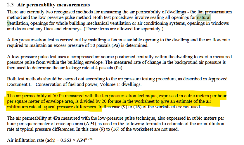

In SAP 10.2 it suggests dividing by 20 is good enough:
So your 15ish m3/m2.h. would be 0.75m3/m2.h natural infiltration.
Given the heat capcity of air and the temperature difference between indoor temp and outdoor temp, The desinger can calculate what heat loss can be attributed to convection. and include it in his calcs.

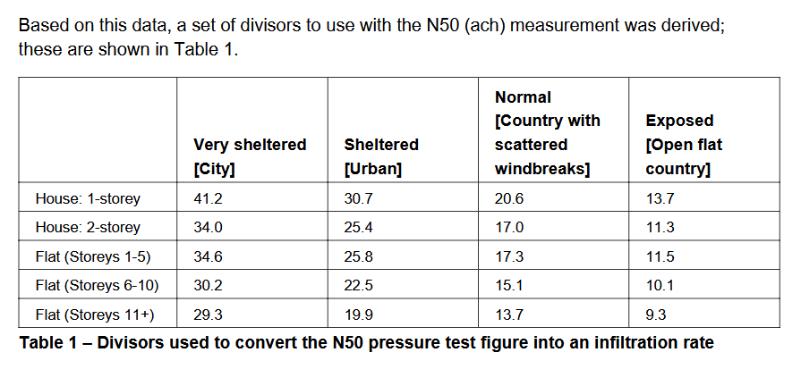

The Home energy modelling methodology which is i think is due to replace sap in the future uses this:
Your natural infiltration is determined through the applicable devider.
You can then refine it further by finding the your locations average windspeed at 10m above ground and nprmalise it by whats is assumed in the table, which is 4m/s wind speed at 10m.
I think the logic would apply to ACH or m3/m2.h figure as they both mesure the saem thing
lets say yopu live in a sheltered urban 2 story house. where the average windspeed at 10m above the ground is 2m/s. (15m3/m2.h or 10ACH)
15/25.4= 0.59
0.59* (2/4) = 0.295m3/m2.h
10ACH/25.4=0.39
0.39*(2/4)= 0.195 ACH which would then be converted to unit depending on house to be used in the calcs.
